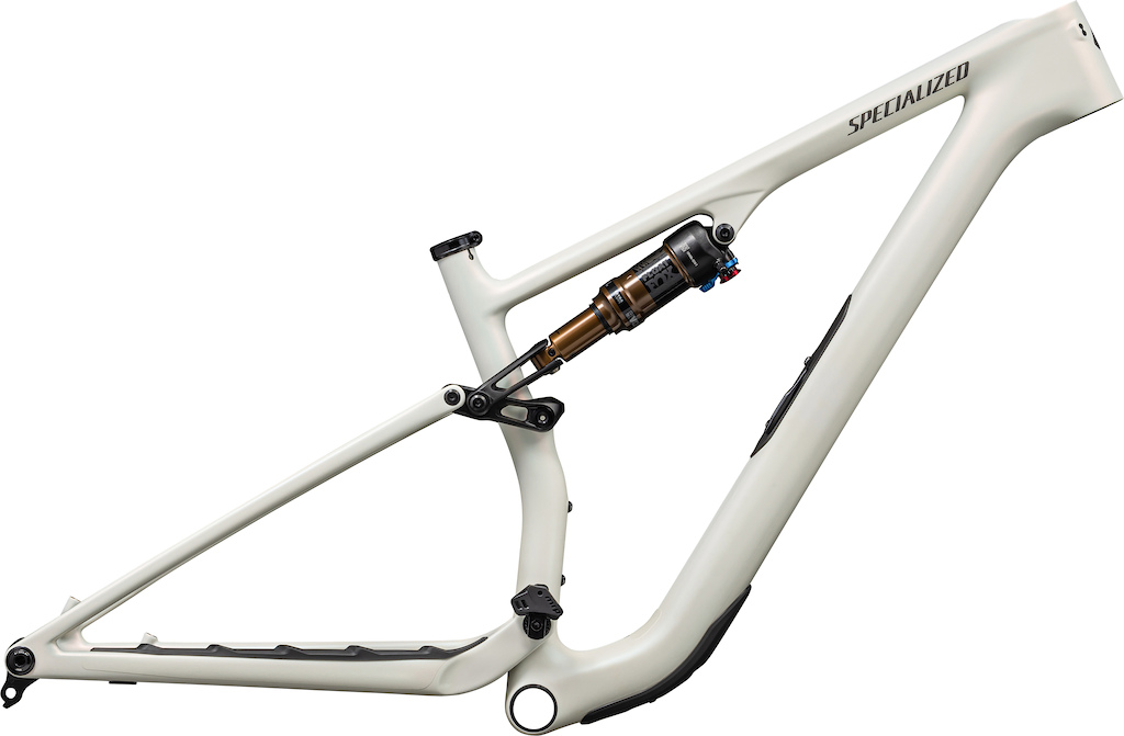

Since the EVO's frame is identical to that of the Epic 8, I'll cut to the chase and plop the same details here as well. One notable exception is the S-Works frame, which won't be coming in an EVO spec at this time.
It should be no surprise that the Epic 8 comes exclusively in carbon fiber, but it's not quite as simple as one single frame offering. As per usual, Specialized is releasing the bike in the standard 11m layup, with the S-Works 12m frames allocated to the Epic builds. Both frames have stiffness profiles tuned to each size's typical rider, meaning an XS will be far more compliant than the XL. This requires some re-engineering with each new layup schedule, and hopefully yields a better ride for each person in the range.
The big news with these new frames is the introduction of SWAT storage to the Epic platform. Where it had been avoided in the past due to weight considerations, the bike's now feature the 4th version of the system. The door is more secure than past versions, the lever is easy to operate, and the door feels very secure and stable, even with a full bottle on top. Apropos of Seb's recent poll, it seems people are split on how passionate they are about the in-frame accessory cubby, but I for one am a fan.
In order to shave some precious grams off the frame (perhaps to make up for whatever gains accompanied the SWAT addition), Specialized co-molded the upper shock mount into the frame, making for an extremely efficient layup. They even went so far as to machine material away from the underside of the toptube at the forward shock mount, removing material and giving better access to shock lockout cables.
Frame Weights
Claimed weight for SM and MD S-Works frame + shock: 1795g
LG: 1840g, (45g more than medium)
XL: 1905g, (110g more than medium)
The 11m's frame materials, layup, and steel hardware + alloy shock extension put those frames 170g over S-Works 12m frames.
Same frame as the Epic.
But with a beefier shock.
